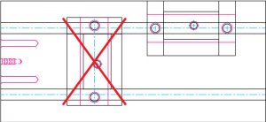

Mounting the Cutoff Riser Block to the Crosslide
The riser block is designed to be mounted on one T-slot, as in the diagram to the right. This orientation offers more structural rigidity to the riser block and the clamping points that are in a direct line with the forces, which are exerted on the cutoff tool when it is in use.
